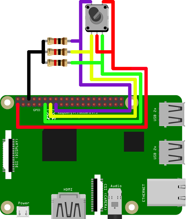

These are for 3.3V rotary encoder but should work for 5V just change the power pin from pin 1 to 2 or 4

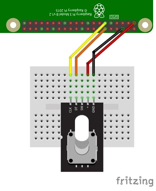

ALTERNATE
Code: Select all
from RPi import GPIO
from time import sleep
clk = 17  # pin 11
dt = 18  #  pin 12
GPIO.setmode(GPIO.BCM)
GPIO.setup(clk, GPIO.IN, pull_up_down=GPIO.PUD_DOWN)
GPIO.setup(dt, GPIO.IN, pull_up_down=GPIO.PUD_DOWN)
counter = 0
clkLastState = GPIO.input(clk)
try:
        while True:
               clkState = GPIO.input(clk)
               dtState = GPIO.input(dt)
               if clkState != clkLastState:
                       if dtState != clkState:
                               counter += 1
                       else:
                               counter -= 1
                       print counter
               clkLastState = clkState
               sleep(0.01)
finally:
       GPIO.cleanup()
Those should work!

In the first one, you are using 17, 27, 22 as inputs - I found the following on the CrowPi2 :-
Pin 17, after connecting to my resistor centre tap, swings 0 -> 0.2V - i.e. pin 17 is being driven.
Pin 27, swings 0 -> 0.7V
Pin 22, swings 1.8V -> 2.9V
In your second diagram, you are using Pins 17, 18 as input. We have covered 17.
Pin 18 - immediately triggers sound output - has about 3khz 0.1V peak-to-peak signal.
Thus all these pins are being used already.
