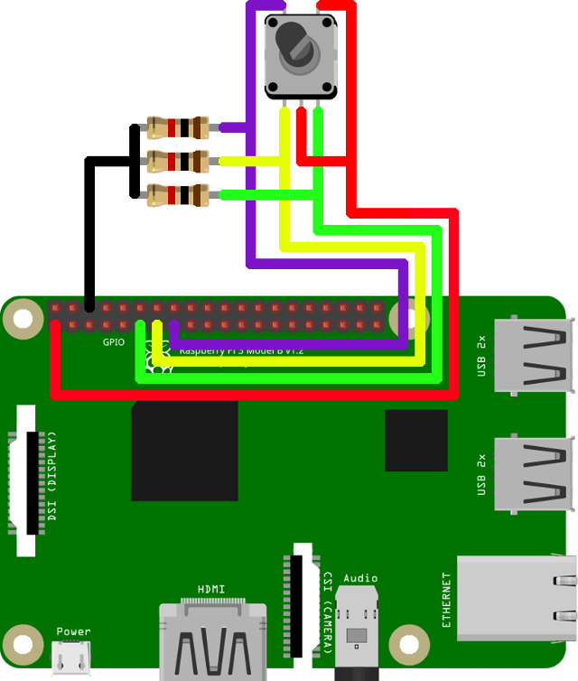

The Crowpi2 legend on the RPi pins is difficult to understand.
My rotary encoder is 5V, so I used a 10k + 22k resistive divider for a level translator.
Because it now has about 8k output resistance, I just tried it on all the pins
while watching the signal to see which I could use as an input ..
I think the UART pins would have level translators - would these be smart, bidirectional ones ?
I found BCM pins 10, 9, 16, 1, 15 to be
high impedance - but I tickled the relay and the buzzer during the tests, and maybe affected other things.

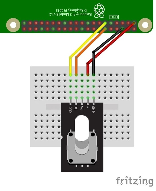

These are for 3.3V rotary encoder but should work for 5V just change the power pin from pin 1 to 2 or 4
Rotary encoder:
python code:

clk = 17  # pin 11
dt = 18  #  pin 12
GPIO.setmode(GPIO.BCM)
GPIO.setup(clk, GPIO.IN, pull_up_down=GPIO.PUD_DOWN)
GPIO.setup(dt, GPIO.IN, pull_up_down=GPIO.PUD_DOWN)
counter = 0
clkLastState = GPIO.input(clk)
try:
        while True:
               clkState = GPIO.input(clk)
               dtState = GPIO.input(dt)
               if clkState != clkLastState:
                       if dtState != clkState:
                               counter += 1
                       else:
                               counter -= 1
                       print counter
               clkLastState = clkState
               sleep(0.01)
finally:
       GPIO.cleanup()
Those should work!

Thanks for your reply.
My encoder, off some old equipment, is 5V. I do not want to drive the RPi pins to 5V, so neither of your diagrams work for me.
I am not going to fritz this, but my solution is 10K from encoder, and then 22K to ground - a voltage divider.
I connect the RPi input to the centre tap.
With that, open circuit, I get a nice square wave on both resistor centre taps of 0 -> 2.7V - great.
In the first one, you are using 17, 27, 22 as inputs - I found the following on the CrowPi2 :-
Pin 17, after connecting to my resistor centre tap, swings 0 -> 0.2V - i.e. pin 17 is being driven.
Pin 27, swings 0 -> 0.7V
Pin 22, swings 1.8V -> 2.9V
In your second diagram, you are using Pins 17, 18 as input. We have covered 17.
Pin 18 - immediately triggers sound output - has about 3khz 0.1V peak-to-peak signal.
Thus all these pins are being used already.
Pins 15 and 16 give me a nice clean 0 - 2.7V swing.
GPIO.gpio_function() on pins 17, 27, 22, 18, 16 all return 1 (GPIO.IN) - so they are driven from the CrowPi2 sensors.
GPIO.gpio_function() on pin 15 returns -1 (GPIO.UNKNOWN).
Thank you for your code snippets - I am using wait_for_edge, but the callback is a better idea.
It all works - I get my encoder value, and can write it to the LED display.
Back to the subject - I need to know which RPi pins are Spare - that I can use as I wish.
