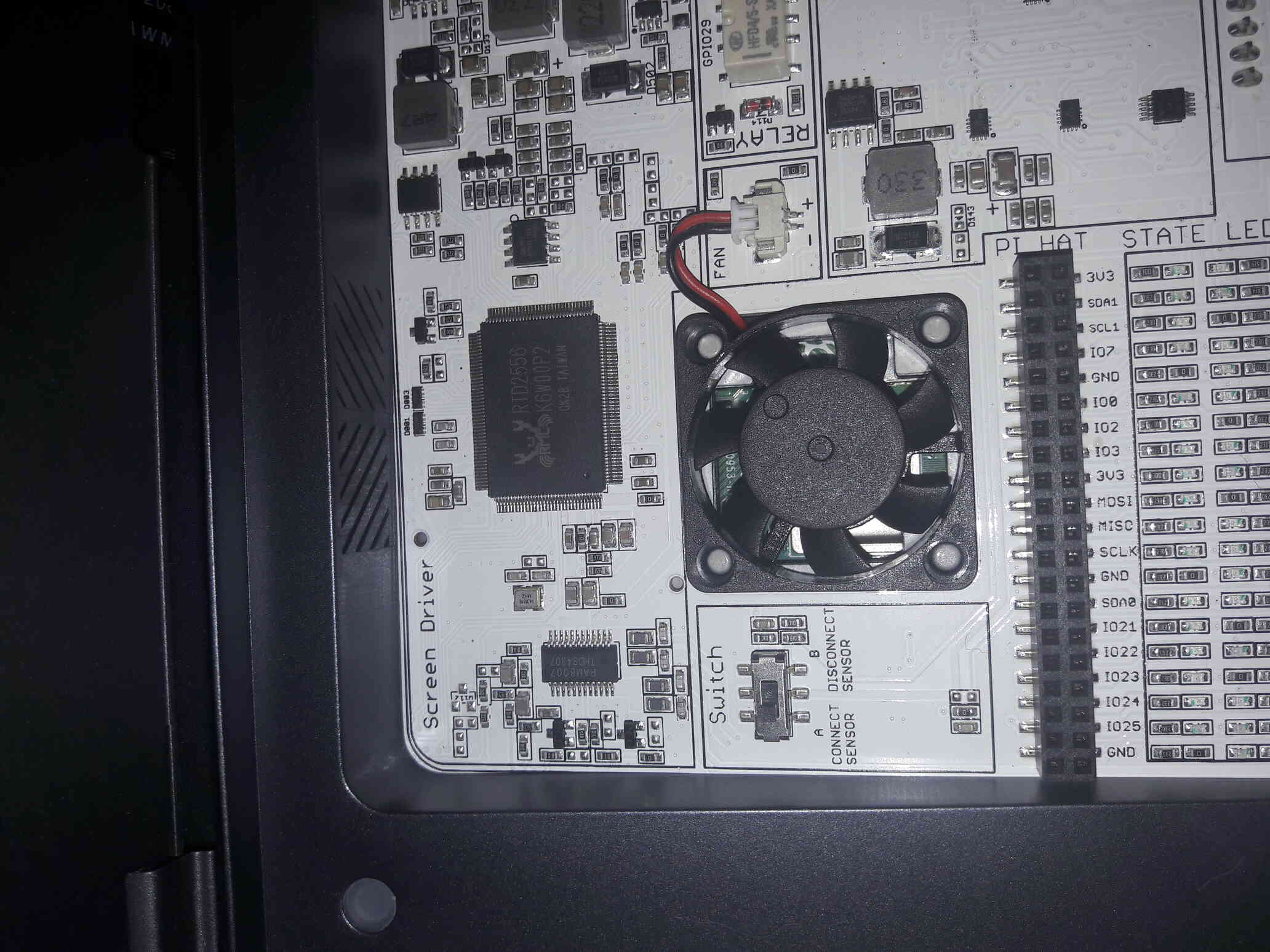

Switch (I think) disconnects I2C from Pi.
Screen driver - converts HDMI to screen.
Fan - right above naked SoC on Pi board.
Led indicators on all Pi connector pins.
Relay

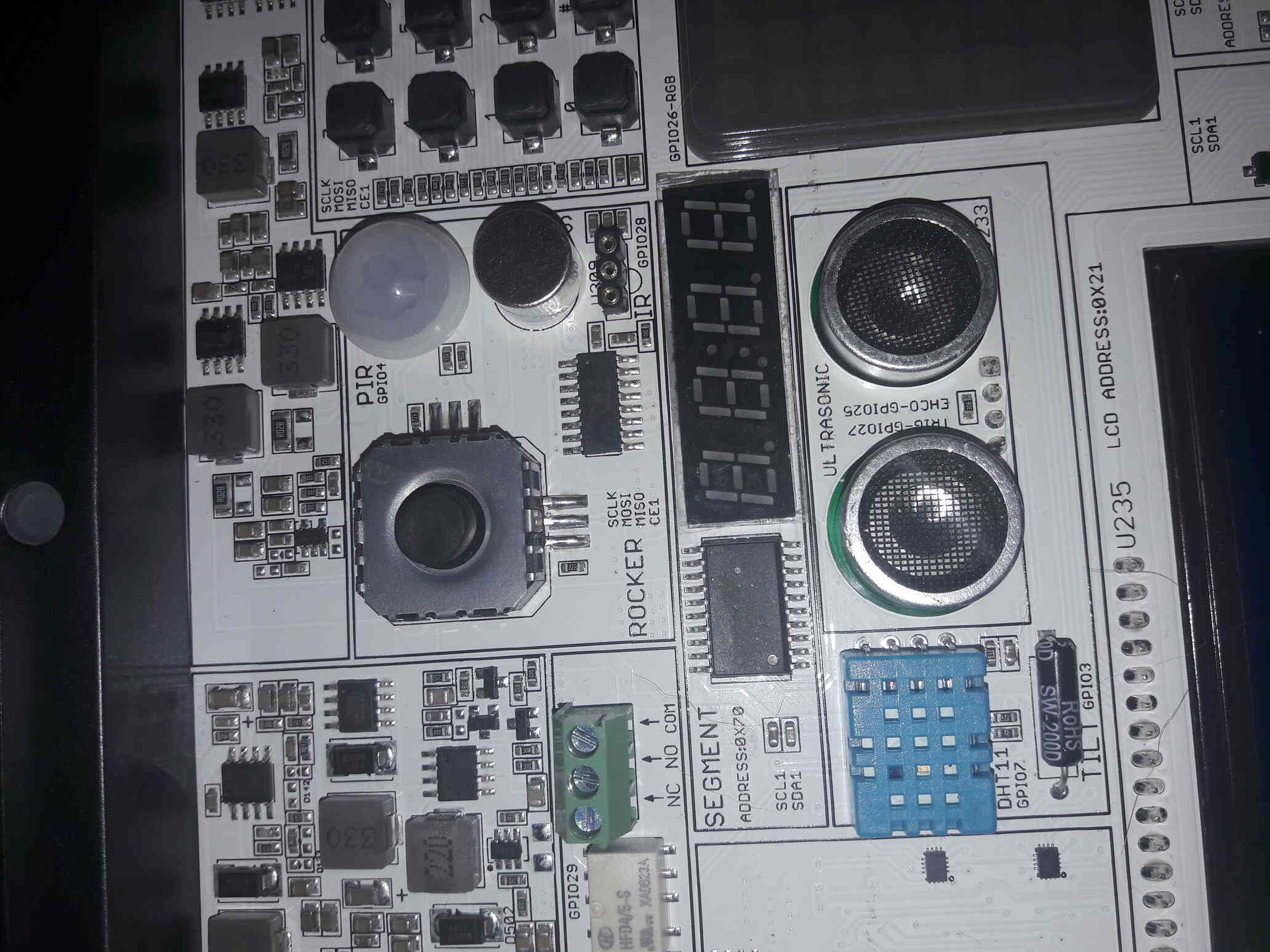

Chip next to 7Seg is HOLTEK-HT16K33 - all-in-one LED-multiplexer / key matrix scanner + debouncer that talks I2C to the Pi4, and handles the 7 seg display, the 8x8 led colour display, and the 4x4
SPI / CE1 to Rocker ?
GPIO to PIR, Sound detector - not entirely sure what GPIO28 is doing.
Ultrasonic - Trig and Echo
Tilt and Temp / moisture on GPIO pins
Power conditioning at the top.

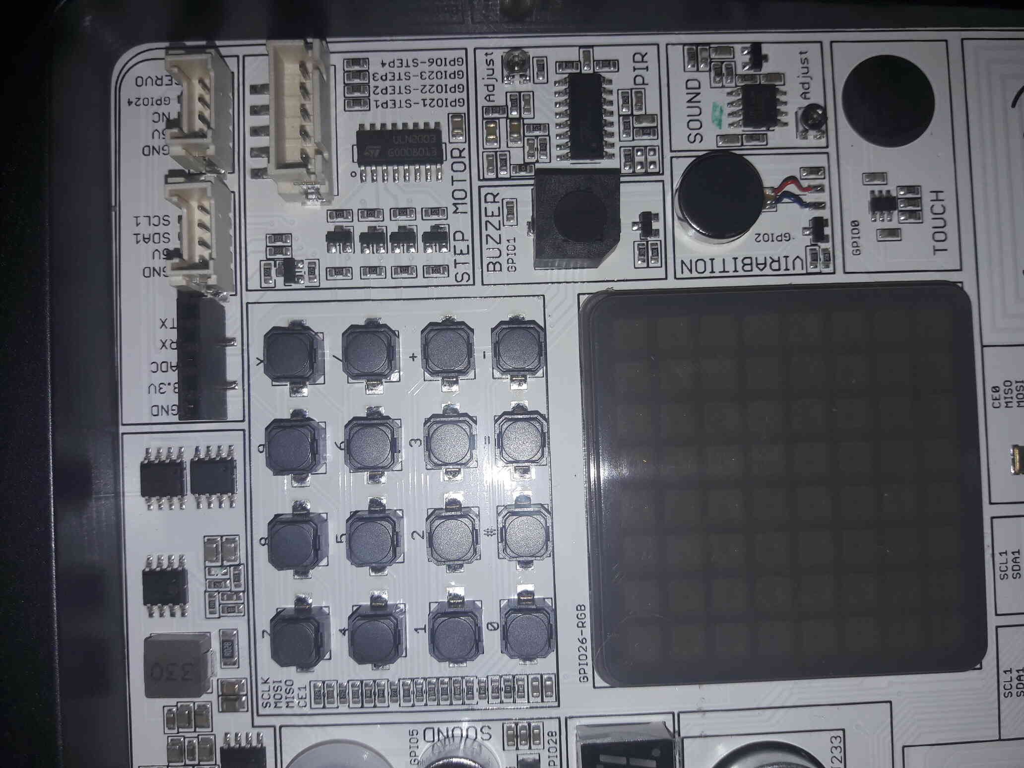

Top has Analog in, UART out.
I2C on connector.
Servo connector.
Stepper connector - drivers below it.
Buzzer - and PIR circuitry ?
Vibration, Sound, Touch.
8x8 colour matrix
4x4 button pad - quite sturdy.

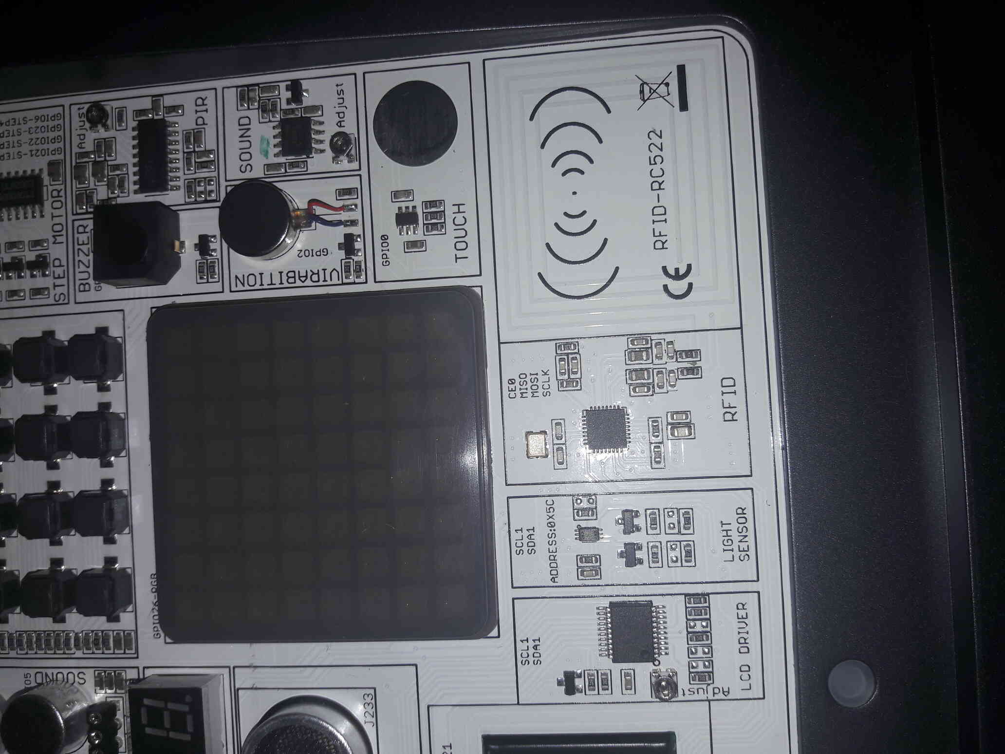

16x2 LCD display driver on I2C
Light sensor on I2C
RFID on SPI

"not entirely sure what GPIO28 is doing"
if it the same/similar as the original crowpi it came with a small remote control and an ir receiver (looks like a transister with a lump on the front, some have a metal case on them) plug that in to the connector and write some code and you have a functioning remote control

You are right - it came with VS1838B - which is an IR receiver IC. Thanks for telling me where to put it ..
