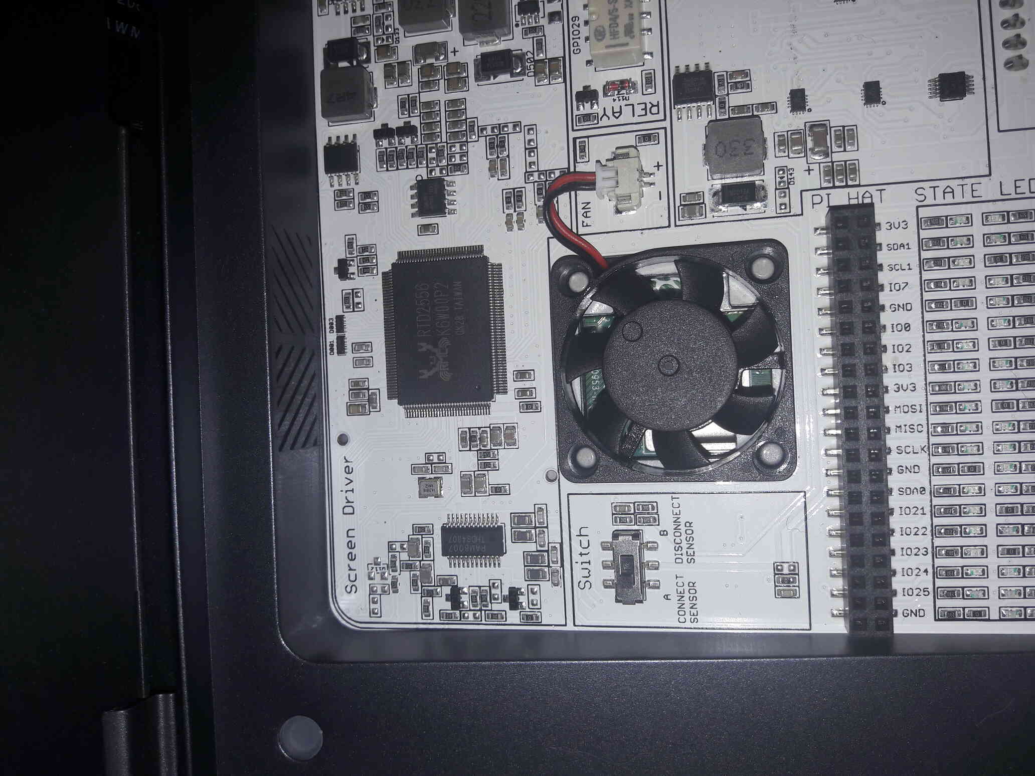

Switch (I think) disconnects I2C from Pi.
Screen driver - converts HDMI to screen.
Fan - right above naked SoC on Pi board.
Led indicators on all Pi connector pins.
Relay

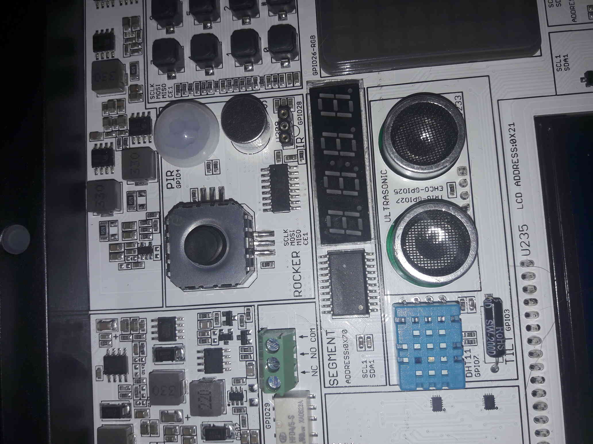

Chip next to 7Seg is HOLTEK-HT16K33 - all-in-one LED-multiplexer / key matrix scanner + debouncer that talks I2C to the Pi4, and handles the 7 seg display, the 8x8 led colour display, and the 4x4
SPI / CE1 to Rocker ?
GPIO to PIR, Sound detector - not entirely sure what GPIO28 is doing.
Ultrasonic - Trig and Echo
Tilt and Temp / moisture on GPIO pins
Power conditioning at the top.

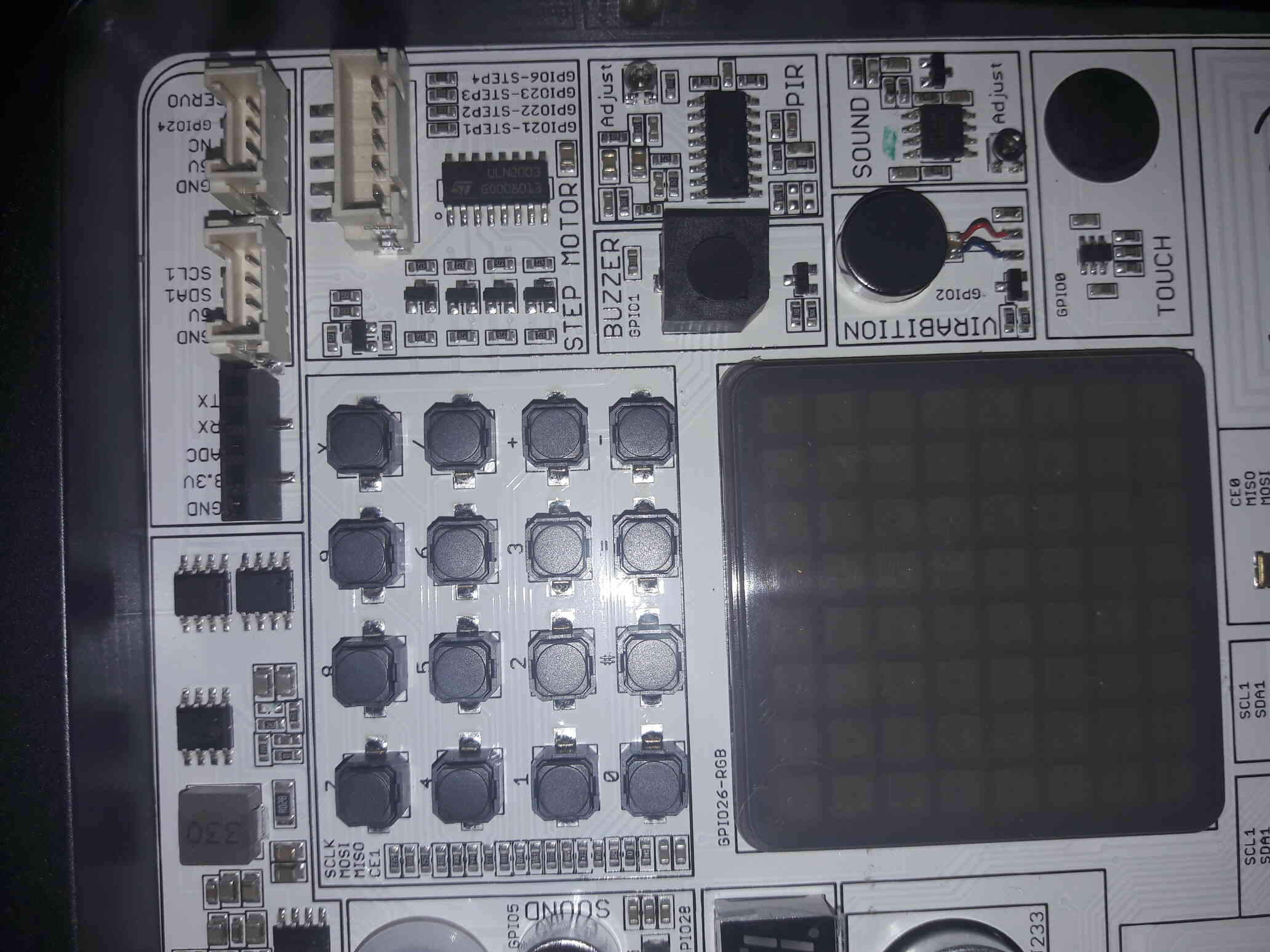

Top has Analog in, UART out.
I2C on connector.
Servo connector.
Stepper connector - drivers below it.
Buzzer - and PIR circuitry ?
Vibration, Sound, Touch.
8x8 colour matrix
4x4 button pad - quite sturdy.
I2C on connector.
Servo connector.
8x8 colour matrix

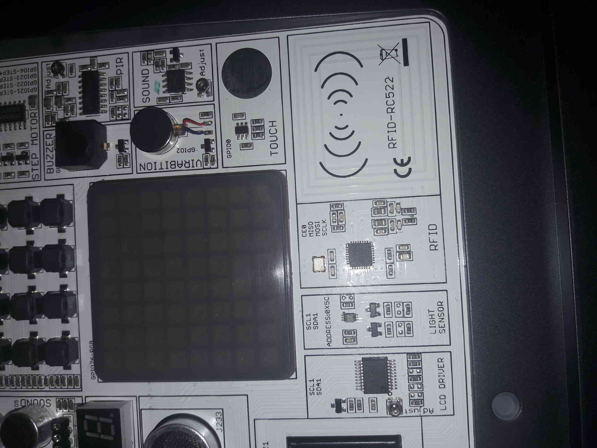

16x2 LCD display driver on I2C
Light sensor on I2C
RFID on SPI
Light sensor on I2C
RFID on SPI

It came with power adaptors for Pi4 (USBC) and Pi3 (microUSB)
There is also a connector for HDMI - one for Pi3 another for Pi4
Tray is way too small for a battery pack - still thinking what to do about that
Fan a teeny bit noisy - maybe a heatsink on the Pi is enough - the fan pops out, I guess the heatsink would just go in its place
