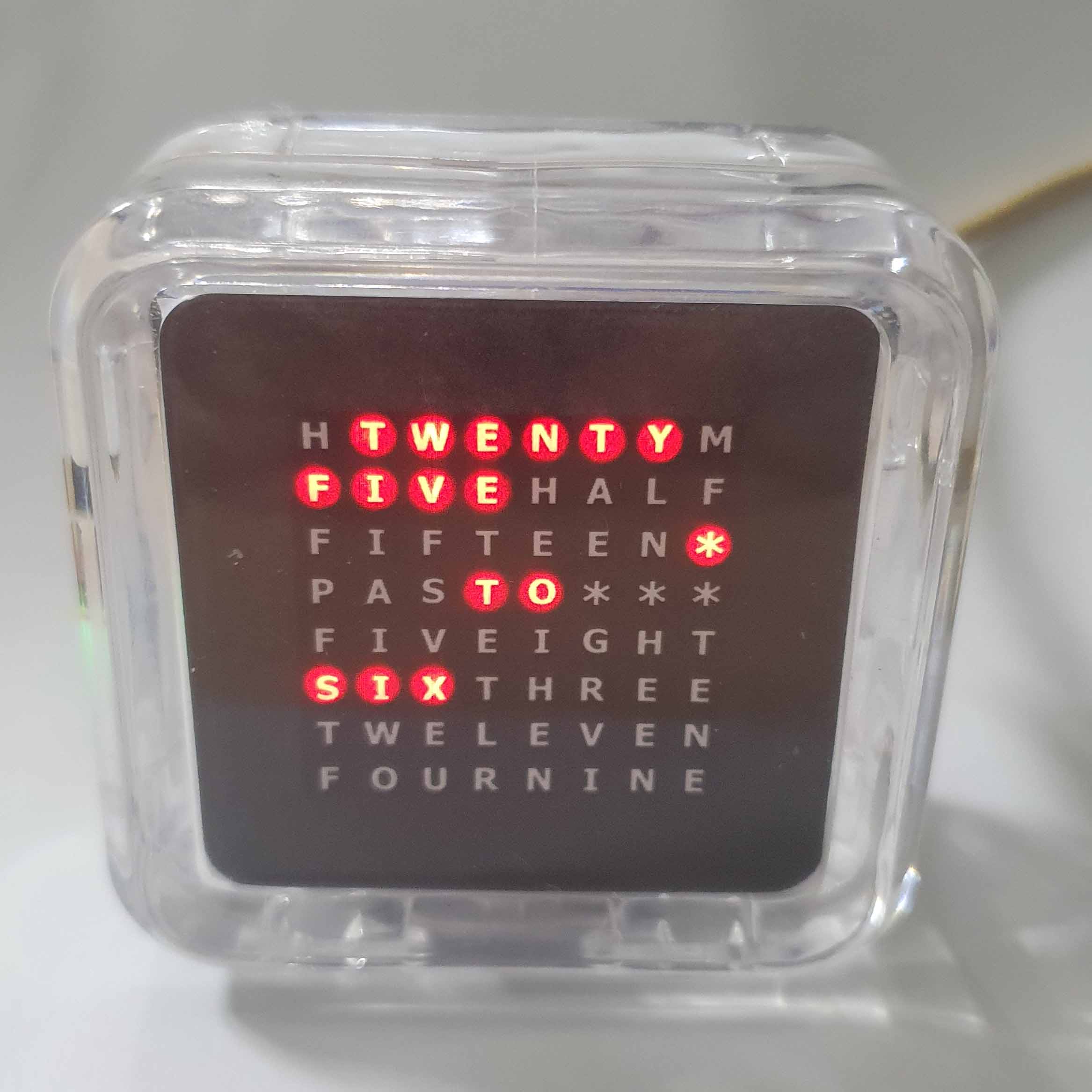

my little python project I was working on during the lockdown (Movement Control Order here)
the code is far from perfect but it ... works!!
the attached file
word.clock.face.zip
(4.15 KiB) Downloaded 10954 times
contains an .svg file for the face (setup for A4 paper)
use inkscape or your favorite .svg editor to print it out and place on top of your 8x8 LED Matrix
to read the clock the five-minute intervals are displayed at the top, there are up to 4 asterisks
to make the time more precise (add them to the five-minute interval displayed) and that will be
either how many minutes PAST the current hour or TO the next hour and then the hour on the lower half

So I took my word clock to the next level
I modified the above python script a little
1) to use a waveshare i2c 8x8 led matrix
2) and a chronodor (adafruit chronodot knockoff) i2c rtc (real-time clock)
3) Adafruit Trinket M0 with circuit python on it

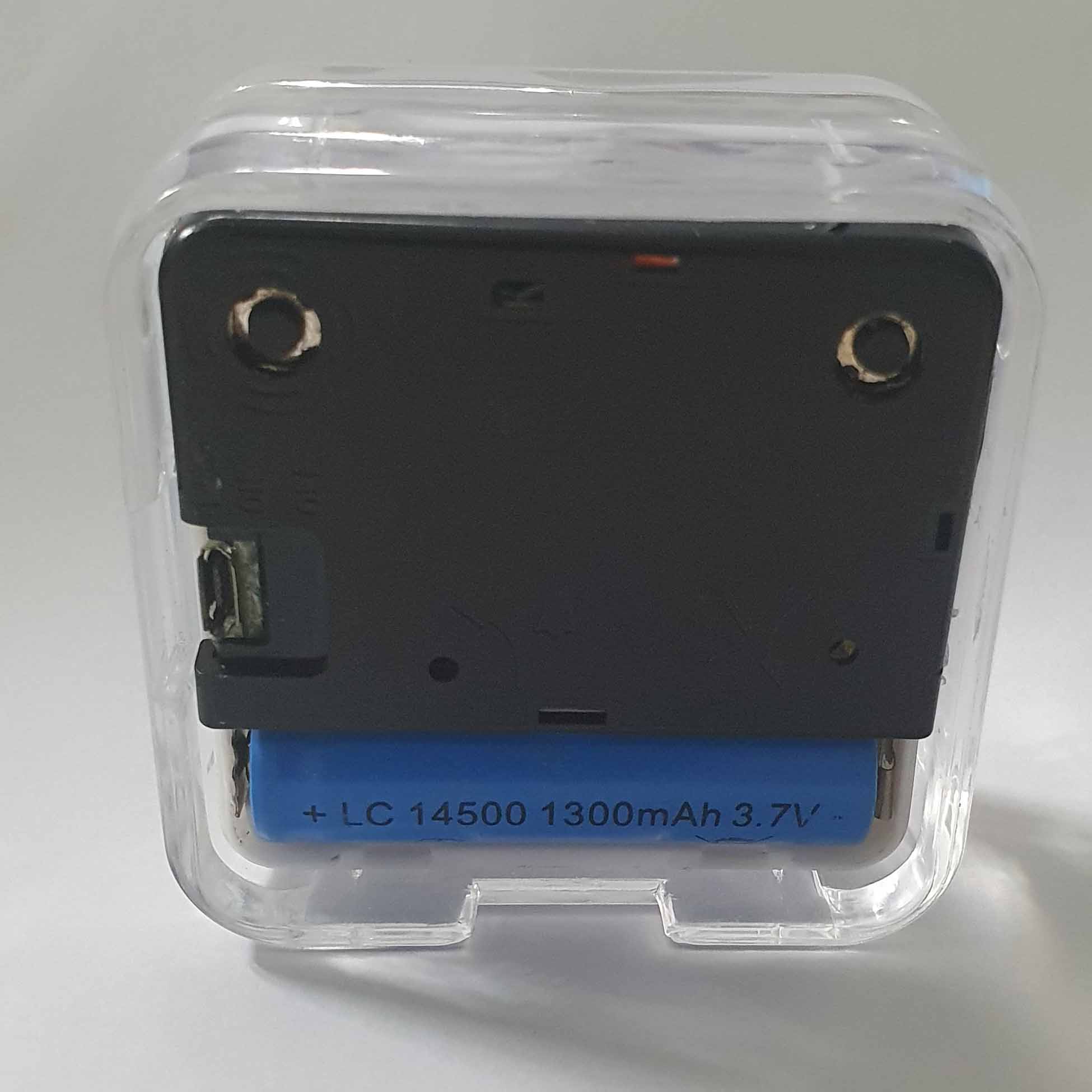

I needed some way to set the clock so two(2) buttons on the back and a few extra lines of code
instead of using a watch battery to provide backup power to the rtc I used an LC14500 rechargeable 3.7Vdc battery (same size as the AA battery)
and an old small gutted clock case.
It does need an external power source; USB connection from a computer or a standard phone charger (with micro usb connection)
